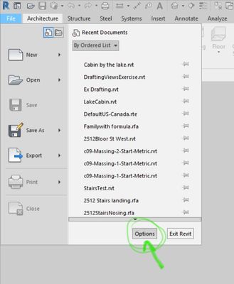

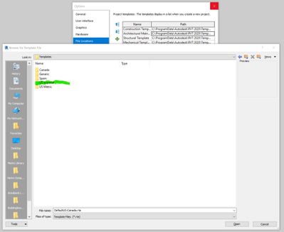

atticushuldshinsky
I had the same problem and I found that the file loaded when I choose Architectural Template wasn't the appropriate.
1. Go to Revit options under File menu.
2. Once there click on File Locations.
3. Check the path assigned to the Architectural Template. (In my case I changed it to the Canadian version)
4. Click on the three dots at the end of the path and a file browser will open.
5. Navigate to the US Imperial folder on the Templates directory, and select the default.rte file
Hope this help you.
