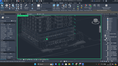

If i understand your problem right, you can use this:
  1. On the View Control Bar, click (Reveal Hidden Elements).
    The Reveal Hidden Elements icon and the drawing area display a color border to indicate that you are in Reveal Hidden Element mode. All hidden elements display in color, and visible elements display in half-tone.
    Example
To unhide hidden elements
  1. Select the element.
  2. Do one of the following:
    • Click Modify | <Element> tabReveal Hidden Elements panel (Unhide Element) or (Unhide Category).
    • Right-click the element, and click Unhide in ViewElements or Category.
    Note: The Unhide Element and Unhide Category options become active when you select an element that was hidden by element or, a category that was hidden by category.
  3. On the View Control Bar, click to exit Reveal Hidden Elements mode.
This is official info from Autodesk knowledge base! Here's the link
This will allow you to see all hided elements (in pink). All unhided element will be shown in gray scale. The problem with this tool is very simple. When your project is big you will see all elements in same time and may hard slow your work.
