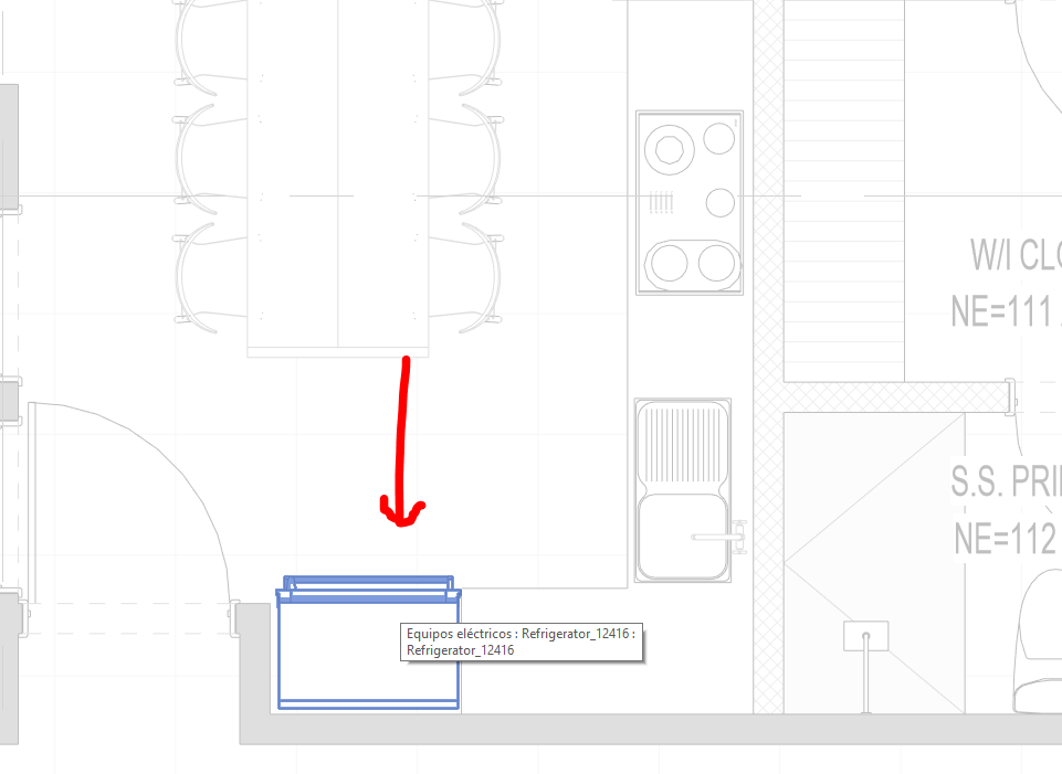

I guess this issue may have been discussed before, but i dont seem to find the solution to my proble.
here's the thing:
1. this element is not being showed on my view- (refrigerator)
I already reviewed everything on my view template, view range, graphic display, checked and unchecked everything repitedly, and nothing seems to work to get it showed.
Entering to the  REVEAL HIDDEN view, I can see the family!
thanks in advace for your help

The fact that the element is displayed when clicking the Reveal Hidden Elements command should narrow this down.
If you select the refrigerator when in the Reveal Hidden Elements mode, do you see an option to unhide it (e.g. Unhide Element or Unhide Category)?

And this is the plan view with the problem
Nachricht 9 von 14
Sahay_R
als Antwort auf: Anonymous
If you switch your View Template to Architectural Plan or even Plano arcquitectonico, the refrigerators will come back. The refrig family is OK - I can see it in a new project and even when I cut a section in your project.

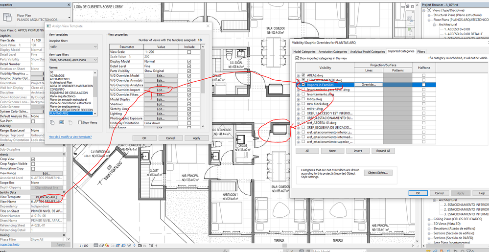

Looking at the family, I can see that the geometry is composed of a DWG import.
The View Template applied to the view, is set to not display Imports in Families (Imported Categories tab of V/G Overrides):
