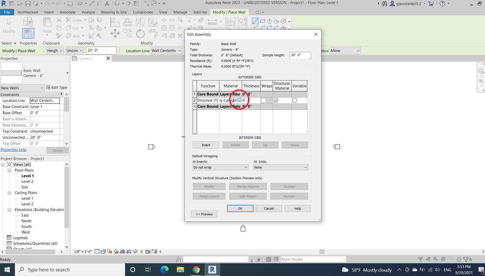

My Revit is 2022  whit student license. I have this problem. I am touching in the edit of walls and nothing.
It doesn't open for me. Its missing.
I tried many ways and nothing.

When you install Revit, did you click on material asset? If you don't, it won't install it. Perhaps you should choose repair or reinstall and click on material.
L.Maas
What happens if you go to manage tab and then choose materials? Does it open then?
Possibly hidden on a second (disconnected) screen?
Did the standard things (restart Revit, Restart computer)?

I have not encountered such an option, but everything else is fine
Absolutely nothing appears, as if there is no push button. I've looked at a lot of topics and tried everything, but it doesn't work. I think some file is missing, but I don't know what and where it should be.

  1. Repair installation
  2. Reset Display resolution to 1920x1200 or 1080 and scaling to 100% or 125%
thanks for the answers. Pre-install my computer. I also install the program to watch the video step by step. But the wall editing does not open.
I still think some folder is missing
