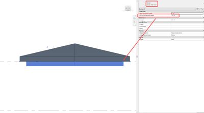

als Antwort auf: HeadbuttJ
Fascia with negative Horizontal Profile Offset
....and maybe a Soffit underneath the Fascia

Roof Fascia is a Sweep created from a Profile Family.  If you can draw your "irregular shaped" Profile as a 2D closed-loop line, then you can create Sweep Geometry from it.
Create a Profile Family | Revit Products 2018 | Autodesk Knowledge Network
BTW: the Fascia Profile shown in my screenshot above is using 1x12 rectangular-shaped Profile.

...I'll add that I don't really see anything "irregular-shaped" in your pictures above.  Looks like a typical box soffit to me.  We model those in Revit exactly the way they will be constructed in the field.
Something like this:
