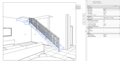

Hello everyone,
Has been trying for some time to produce metal and wood stairs with a stepped central beam.
Does not succeed in any of the revit tools I know.
Does anyone have a suggestion on how this is possible and not in a model in place

You can model the center support as a narrow monolithic stair placed under the main assembled stair.

How do I do that?

@lilachshahaf
Edit the stair width to match the support width in sketch mode.
You will also need to edit the landing shape ti reproduce the « T » shaped junction of the supports as the first riser and landing seem to continue to the left most side wall (in you picture).
