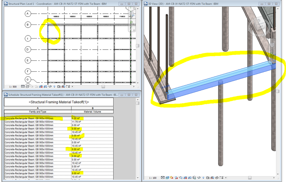

Dear All,
Please give me a solution for this..the beam material is showing for some element and  for some element it is showing as 0.00. All the members are from the same family and type.

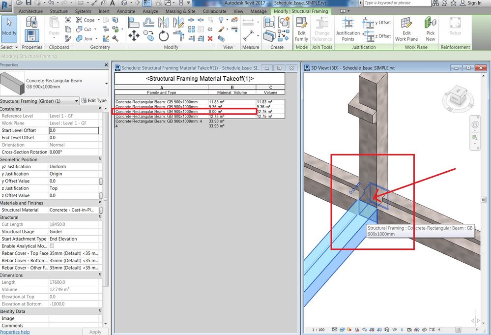

As hotfix, you can use element Volume instead of Material Volume.
Dmitriy Semko
BIM-Manager
Blog
Facebook | Telegram | LinkedIn
Nachricht 6 von 14

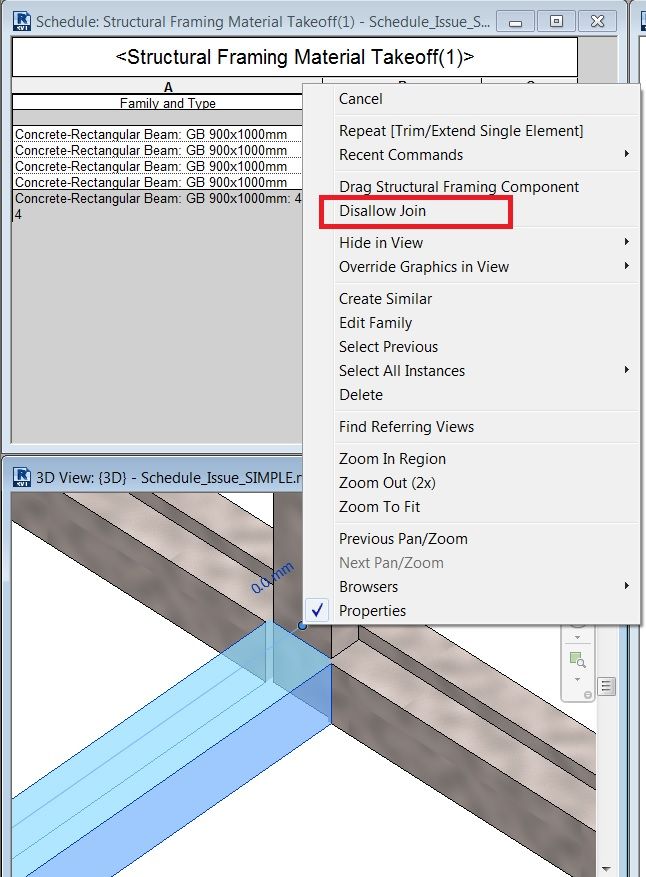

semko_dm
als Antwort auf: shefypattambi
The thing is that columns and beams are joined wrong. In screen capture below you can see sort of phantom geometry inside the column. That fantom belongs to highlighted beam and gives us zero material volume.
If you disallow join and trim the beam to the column surface, that's phantom and zero material value will disappear.

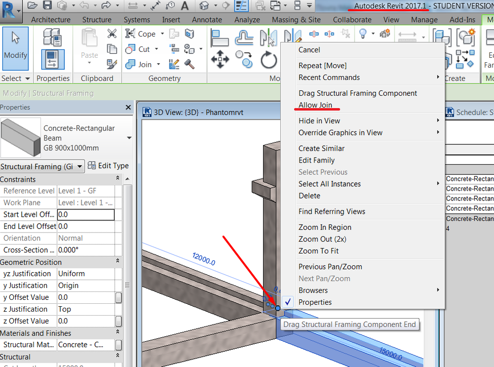

Nachricht 9 von 14
shefypattambi
als Antwort auf: semko_dm
Did you access the disallow join option by right click mouse?
I think this option is gone in Revit 2017.1 version
Nachricht 10 von 14
semko_dm
I'm already on revit 2017.1 and it's still here under right mouse click.

Nachricht 12 von 14
shefypattambi
Now disallow join is appearing once I right click on the drag end bubble. Did you try "switch joint order command'' option. it will eliminate that null volume from schedule and also it would not affect our analytical model.
But I feel that there is some problem. In previous version of Revit  I am always draw the beam from center to center and the beam will cut back depending upon the bounding box set in the beam family. But in this case the bounding box is not working as intended. I have to investigate more.
Nachricht 13 von 14
semko_dm
I won't tried "switch join order command'', but you are right it's the best way, and it have no problem with analytics.
