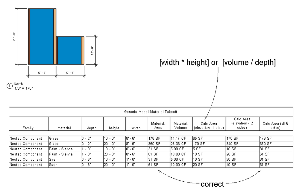

We are modelling curtain panels that will eventually be built as prefabricated units (2600 x 2600). Due to the large scale of the project we need to be able to swap in and out these panels easily and compare quantities (predominantly glass vs solid). This method of modelling is causing us to get incorrect material area takeoffs (each panel has layers of glass and solid elements but when scheduled each material takes on the area of the total panel size).
We have overcome this issue with use of Material : Volume and with use of a calculated value dividing this amount by a shared parameter 'glass thickness' to get the correct material areas, but it seems strange that Revit is calculating the volume correctly and not the area, its obviously collecting the data from somewhere in order to produce the volume?
We could also use parameters within each family to calculate the glass area but we have alot of different families in the conceptual phase and I was hoping to control it at a project level rather than family..
We are also using system panels so the scheduling becomes quite customized and the quality control process slow..
We have also tried to manipulate it in dynamo but come out with the same figures. Any ideas or help much appreciated!

You are right.  The curtain panel material take-off schedule reports the curtain panel area instead of the actual material areas for sub-elements.
I can understand the reason is that Revit cannot determine which areas of the geometry to calculate from: area on one side (the same as your calculated Area based on Volume/Thickness), or area on both sides, or on all exposed surfaces, or on all surfaces).  It does not have the same problem with Volume because there is only one Volume.
I think if you want to calculate the elevation area of the material, you can safely forfeit the Material: Area for the Curtain Panel Material Take-off schedules and use the Calculated Value as you already demonstrated.
If you want to calculate the total exposed (or not) surface of the materials, you need more a more complex formula, for example:  2*(Width+Thickness) * Height (Width, Thickness, Height are dimensions of the sub-element, not the curtain panel).  Another possibility (I have not tested it myself), is nesting shared families as components in your curtain panel family.  Then create material take-off schedules for those.
Nachricht 6 von 8
als Antwort auf: brwhi
I have made a test for a curtain panel with nested and shared components.  The material take-off schedule (of the component category, not the curtain panel category) report the correct total surface area of each piece.  It probably does not apply to your case because you only need the one-sided elevation area for component, though.
