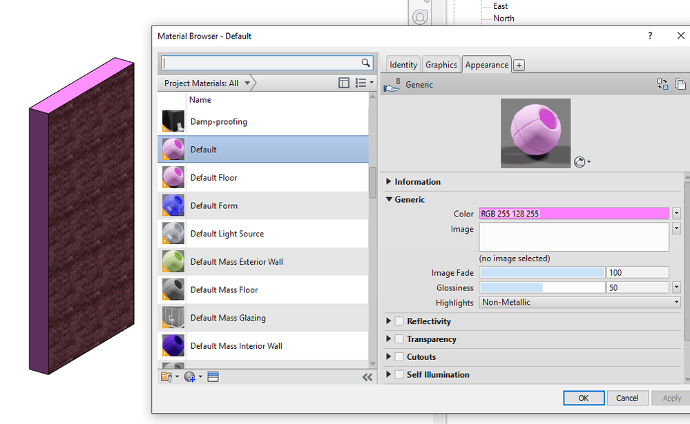

Greetings:
Wall layers are not displaying as set in the material browser Appearance tab.
The wall edges are blue instead.
View is default 3D, Fine, and Realistic.
No graphic overrides in the view.
No phase filter.
No design options in use.
This isn't a big deal but it is annoying. I keep thinking the wall is selected when it isn't.

Almost sounds like an Analytical Representation?
...are you actually cutting the wall?
Nachricht 3 von 13
als Antwort auf: barthbradley
No I'm not cutting the wall. It's the free ends, top and bottom.
Nachricht 4 von 13
als Antwort auf: Anonymous
It's displaying correctly then. That is, the view won't show the wall layers unless you cut the wall or make it into parts.

@Anonymous: Are you by chance wondering where that color is coming from? DEFAULT.a-default.png

Ok, in my case I had to change the material called Default Wall, not Default
Nachricht 13 von 13
als Antwort auf: H.echeva
Because your file has Default Wall as the material for Walls category under Object Styles.  If a wall type has no materials assigned to its assembly then it will use the Object Styles definition.
