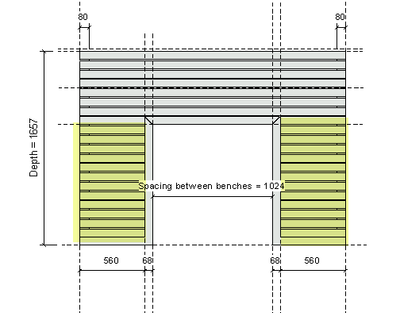

Hi everyone,
I have two issues in a family of a wooden bench. Hopefully you guys can help me out 🙂
1. Within the family, i have made multiple family types for the materials. (walnut/hemlock/abachi)
    When i try to switch between the family types, only a part of the elements are changing material.
    So my question is; How can i fix this so that all the elements are changing materials.
2. When i want to change te depth of the bench, multiple slats has to be automatically generated or deleted.
   So for instance, if the bench is 1657 mm and i want the depth to be 1737, one more slat has to be automatically
   generated. If i want the depth of the bench to be 1577, one slat has to be automaticallly deleted.
I have attached an image of issue 1 and the family itself.
Thanks in advance!
Damian

Alfredo_Medina
About the materials: I see that the solids are associated with a material parameter. That is OK. If you want to see more difference in the materials, then edit the materials.
About the repetitions: these two highlighted areas are extrusions, not arrays. How do you expect that to increase the number of slats if it is not an array?
I recommend you to watch this video, approximately from minute 10 to minute 25:
https://youtu.be/hwRpAhSVSR4?si=dhXvFPzGcEF0Yduk

The name of the material is changing, but maybe not the appearance. That can happen when materials are edited incorrectly. When the user edits one assets and affects other materials that are using the same asset.

Alfredo_Medina
The slat in the array of slats is associated to a material, but the material does not change in the Realistic mode that you are using because all 3 materials use a custom image that is missing.

damian_anoep
Thanks for the replies!
The issue with the materials is solved, thanks!
