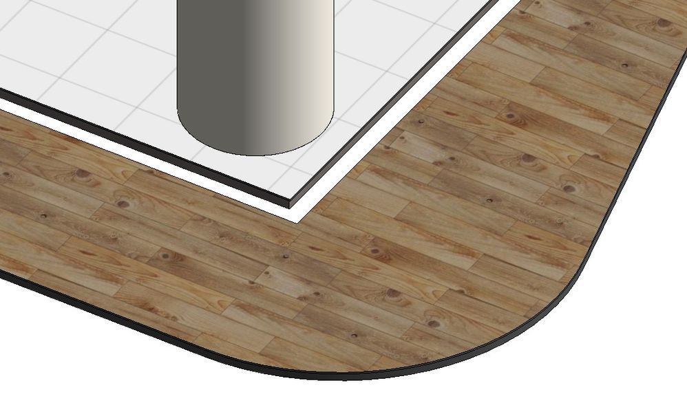

Could you pl have a look at the images shown below, the tile pattern (both ceramic tile and wooden tile) location and orientation is not matching b/w Navisworks (First image) and Revit (Second image).
Difference in Ceramic tile could be seen at Column base and the wooden tile orientation is obvious.
The ceramic tiling is default Revit material ( refer bottom most image) while the wooden texture is an image loaded into the material appearance. FYI.
Pl help me to fix this issue. Your any tips would be highly appreciated.

Its supposed to be exactly same as in Revit Model. can you share the sample model

Thanks for your reply @_Vijay,
Attached the files extracted from my main model. wooden tile texture image also attached for your use.

Your problem seems to be with Navisworks rather than Revit. A quick search in the Navisworks forum reveals it is a known problem and the workaround is to manually duplicate the material in Navisworks and reapply to the objetcts in Navisworks:
Navisworks Forum: Revit Export Navis Texture Mapping
Navisworks Help: Revit material textures won't import properly in Navisworks
@michael.coviello : Is there any word on the developement team's take on this known issue and is my summary description of the workaround correct?

Try with attached RVT and NWC let mw know your comments.
