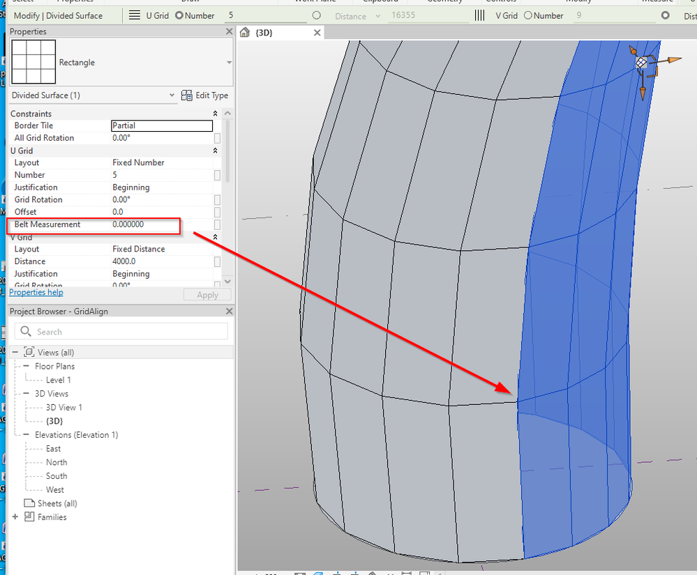

As you can see on the attached picture, I want to have the pattern align. For some reason it is divided in half and the pattern doesn't align.

Open Configure UV Grid Layout and play with Belt Measurement ( between 0 to 1) for U

Hi @constantin.stroescu ,
I will try it but just one question, doing this manually, can we get it that is is perfectly aligned?

in my test example a pair of Belt setting 0 and 1 it is OK even if I make an advanced distortion of the mass object....You have to try it in your case...
