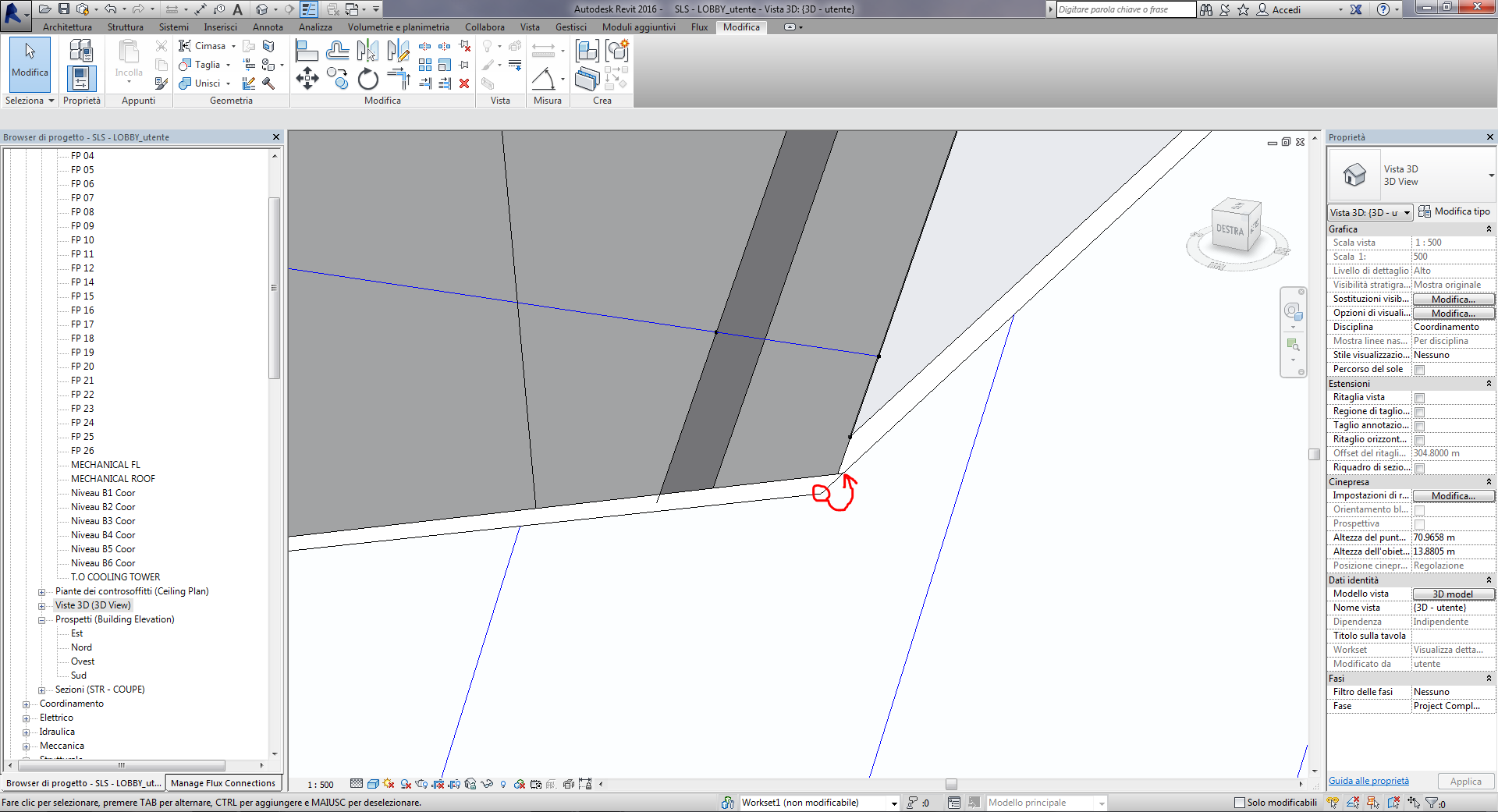

Hi Everyone,
i have a problem with a mass with no volume, i find it totally impossible to modify the mass shape according to my needs.

How was it created?
Nachricht 3 von 16
Irreb
als Antwort auf: Irreb
is a simple conceptual mass with no volume created by 3D points and divided by reference planes

of course I know that, it is an in-project mass but it's for me impossible to change its shape, I can edit it by clicking on it and click again to the toolbar to modify the surface shape...after doing this it continue keeping the same shape it had before showing no one warning

Make sure you use TAB to select the Form and not the divided surface.  If select correctly, after click Edit you should be able to see and alter all the points defining the form.

As it is more of a surface than a mass with a volume, try to associate it with a plane. Then you will have a better control over it.
Nachricht 11 von 16
RDAOU
als Antwort auf: RDAOU
Hey @Irreb
looking at the model you attached on the other post, I have seen that You have a surface which you divided then on it you have placed model lines and and points so that you use to place your adaptive panel later
  1. You divide the surface
  2. You enable the U and V grids from the ribbon
  3. You rotate the Grid to suit the surface
  4. You adjust the U and V grid layout by setting the desired number in the properties pallette
You do not add flying unhosted lines and points to divide your surface with.
Second part on the surface...its flying in space.. If you edit its profile you will never be able to control its shape as desired
  1. Set a Referance plane to match your elevation
  2. Give it a name ... FR
  3. Start the Mass In place and set that FR as the workplane
  4. Place the points on this plane... associated with it
  5. Then select two points at a time and use spline throu point tool till you complete the profile
  6. Finish your mass
Now you can divide its surface as per Part one of this reply

This is how your surface or what your divided surface should look like (no model lines and points to divide
