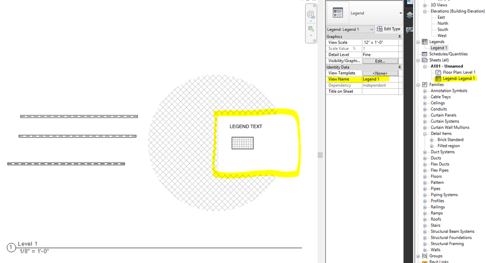

It seems to work here.  The circle area is a Filled Region in the floor plan view.  The highlighted rectangle is a Masking Region in the Legend view.

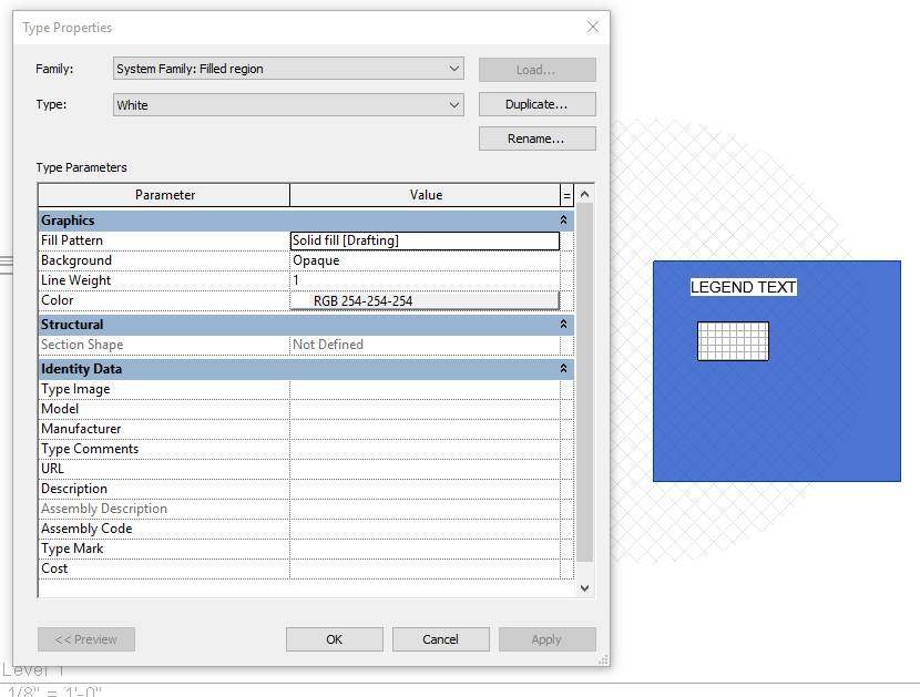

Sounds like a bug.  But you can fix it.  Instead of a masking region, draw a filled region with solid pattern and 254,254,254 color (do not use white).
