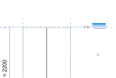

Hi all,
I have to mask a a connection within the family but when i loaded it into the project the mask region is not asking what it should. Any ideas?

i would try the following:
- ensure masking region is on a plane that is above the object being masked
- upload the family so we can look at it and play with it

Nachricht 8 von 15
als Antwort auf: XXalessio.amodioXX
  1. In Plan View, place a Vertical Ref Plane on the Right Side of the two geometries in the View, and then name the Ref Plane.  NOTE: Make sure to draw the Ref Plane slightly offset from the geometry.
  2. In Right Elevation View, Set the Current Workplane to the Named Ref. Plane you just created above.
  3. Draw your Mask Region on that name Ref. Plane, and then uncheck "Draw in Foreground".
  4. Load into Project. Masking Region now fully covers elements behind it.

Nachricht 9 von 15
XXalessio.amodioXX
als Antwort auf: barthbradley
Nice call the trick  Ref Plane slightly offset from the geometry.
