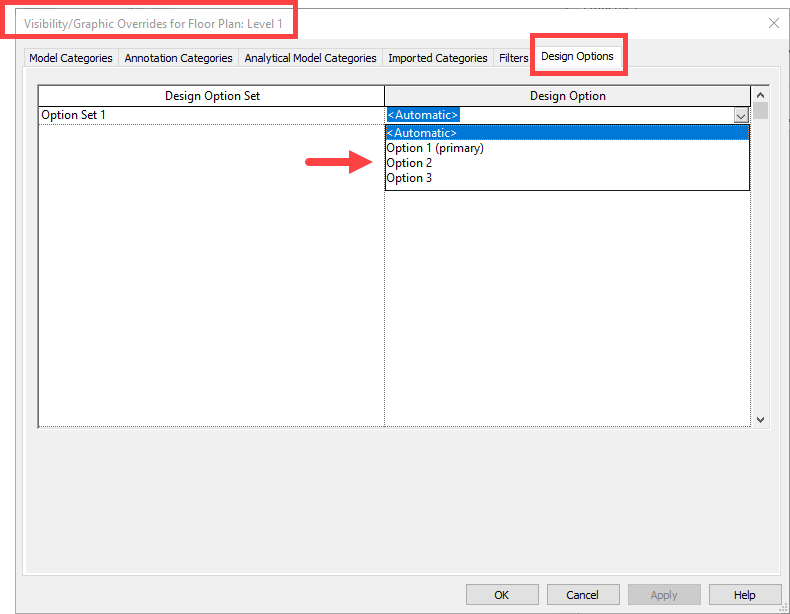

That's it I want to promote an option as a new primary option.
I understand how to change it in the view but changing it in the view template section will only change it in that view whereas I want to promote say option B to be the primary for the entire project.

Then make the Option Primary.  If you no longer need to other Options, then delete them and Accept as Primary the remaining last Option.  This will cancel out the Design Option Group as well as the Views dependent on them.   Get it?  Or is it that I don't get you?   Help me out so I can help you.

Because you only have one view, the Tags dimensions etc, are associated with the elements in the design option you placed them on.  by switching the Primary, this switches the elements in the main model and therefore, as far as the main model is concerned the other elements no longer exist and can not be referenced by the tags/dims etc.
As @barthbradley says, the standard workflow would be to have 2 views.  If you do not want to have 2 views, then I would think that if in both DO's, instead of deleting and recreating walls etc, you just adjusted the same wals and elements, then the association to the elements between DO's shouldn't break, but instead update.

There is no Design Option workflow without dedicated views.
Annotations and details (such as keynotes, dimensions, and tags) are view-specific elements. They cannot be part of a design option.
To document a design option, first dedicate one or more views to the option. Then add the desired annotations and details to the dedicated views.
