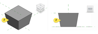

First, you need to create a form. The form can be created in 3 different methods or places: with the mass template, with the generic model adaptive template, or in the project as a model in-place element. Since we are talking about the adaptive template in this article, we will use that option. After creating the form, you need to use the Wall by Face tool to create walls on the tilted faces of the form.
In the generic model adaptive template, reference level view, we will create two squares (or rectangles), A and B, as shown below. Square A is hosted on the reference level. Square B is hosted on a reference plane (indicated as RP in the image); this reference plane has been created at a height that represents the top of walls, and has been named such as “top of walls”. Square B is larger than square A, so that we can create four tilted surfaces after merging the two squares into a form.
Select the two squares and use the Create Form tool. In the image below, one of the slanted faces has been labeled as F. Notice the cube says “Front”, but, to work on that elevation, in the Project Browser you need to select the “Back” view. (Don’t ask me why).tiltedsurfacesback.png
Go to the Back view. Now you draw a triangle with reference lines. Where? On face F. To make the reference lines stay aligned to face F, click on the tool called “Draw on Face” (shown below). Then draw the triangle with reference lines. For this example, I drew the 3 lines without using 3d snapping, and I used a slope of 35 degrees.
Turn the view to the opposite side, and repeat the steps, to create another similar triangle on the opposite slanted, using the Front view. Then select the two triangles, and use the Create Form tool. That will create the “gable roof” volume. Then use Join Geometry to join the two forms.

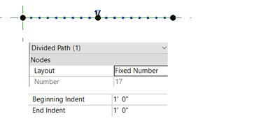

Then, I select the spline and use Divide Path, to divide the spline into a number of nodes that will be the hosts for the repeaters.
Thinking of the gate, and thinking of leaving the ends of the body of the Stegosaurus/gate without a bony plate at the ends, I set up the number of divisions as 17, and I apply an indent of 1 foot at both ends.
