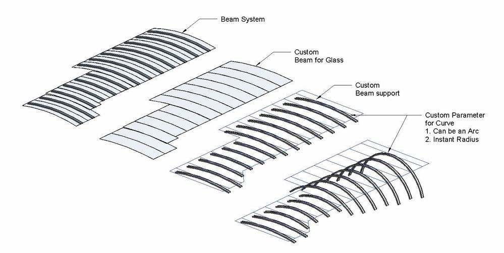

MAKING CANOPY
I want to make canopy like this with revit.
What should i do or how can i get that tutorial.
Thanks you

Hi
1. If you are familiar with Adaptive point, Massing then you can achieve this in one piece.
2. If you are not comfortable in Adaptive point families, then you may split the canopy in
segments, and model them one by one...
3. Easy way is Adaptive family.
4. Easier than that would be Structural Beam system... Theres a bit of learning to control
beam, edit parameter cause its custom design but it will take minutes to achieve it with scope of
making changes..
Have a look.
1. Easy to create Roof PLAN profile
2. combine two roof ( first glass or cover , second structural beam, support ) to achive the roof
3. easy to apply material individually or in on go in type family.
4. Custom instance parameter of changing profile in cut section will allow easy design changes..
Using Beam System, with modified beam with new parameter to bend it ( Radus in sketch mode )Using Beam System, with modified beam with new parameter to bend it ( Radus in sketch mode )
if the cut section is not an arc, then you may need to customise the profile and give more than 2 or 3 radius to achieve it..
Best luck.
Corsten
