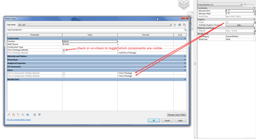

A couple of Yes/No parameters are needed. One that is associated to the geometry's visibility parameter and the other that is controls whether it is checked or unchecked.
First Yes/No Parameter named "Fixed"
Second Yes/No Parameter named something like "Geometry's Visibility". This one is driven by Formula "=Fixed".
When "Fixed" is checked, "Geometry Visibility" will be automatically checked. When "Fixed" is unchecked". "Geometry Visibility" will be automatically unchecked.
