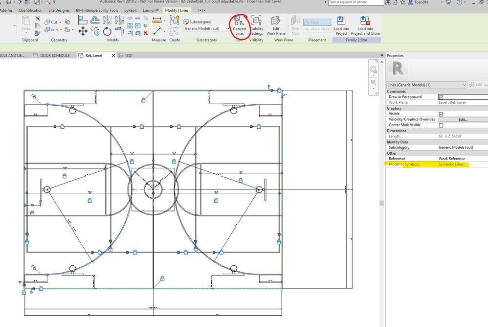

As I said, they are symbolic lines so they do not show in 3d.  Convert them to model lines and keep that in mind so next time you can draw them as model lines from the get go.
See revised file.
