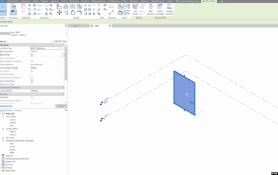

Hello Everyone,
I'm looking for a good method to make a cavity on a wall. Attached I have an image of what I want to do.
BTW, my cavity is not only vertical.

Several ways...here are 4 fairly simple options you could use
Option 1: Use an in-place void Sweep or Extrusion to cut wall element
Option 2: Use the tool Wall: Reveal
Option 3: Use a Face based Generic model to model the U Profile + the Void that will cut the wall
Option 4: Add the Wall Cut as part of the insert family (that element to the left looks like an insert - door/window)

Thank you very much for your response.
The "Wall reveal" method works. But I'm not very comfortable using it since I have to work in 3D mode to use it.
I had thought about the void sweep and void extrusion. But I could not subtract anything from the Wall element using neither Void sweep nor void extrusion. What is your opinion on that?

@mahanmotamedi1991
Use Cut Geometry before you finish the inplace void
