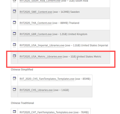

I'm using Revit2020, and I don't have any US metric door families in my program files. When I try to "load family" there is nothing there to load. I have the US imperial door families. This is the file path where the files are supposed to be: C:\ProgramData\Autodesk\RVT 2020\Libraries\US Metric\Doors
There is only the "comercial" folder which has one .rfa file for an exterior revolving door.
Does anyone know how I can get these files? I tried the family templates executable download, but that was something else-- I wasn't missing that. (RVT2020_ENU_Metric_FamTemplates_Templates.exe) Thanks in advance,

Download and install the Metric Content File.
https://knowledge.autodesk.com/support/revit-products/troubleshooting/caas/downloads/content/autodes...
...sounds like you downloaded but didn't install. It's an exe file.
To apply the content files:
1, Download the desired content executable to a local location
2. Launch the content executable from the saved local location
3. Specify the desired content location (Default destination folder “C:\Program Data\Autodesk\RVT 2020”) and choose Extract.

This one: RVT2020_ENU_Metric_FamTemplates_Templates.exe (exe – 100MB)?
This only has a "family templates" and "templates" folder. What I'm missing is the libraries folders for US metric doors.
The attachments are the downloads page where I got the .exe, the folders the .exe added, and the location where my missing files should be.

Did you follow the link I posted above.  Everything you need is there. Scroll down the page and see all the different downloads.
Nachricht 5 von 7
d00158431
als Antwort auf: barthbradley
Thanks! Sorry for the PEBCAK error.
