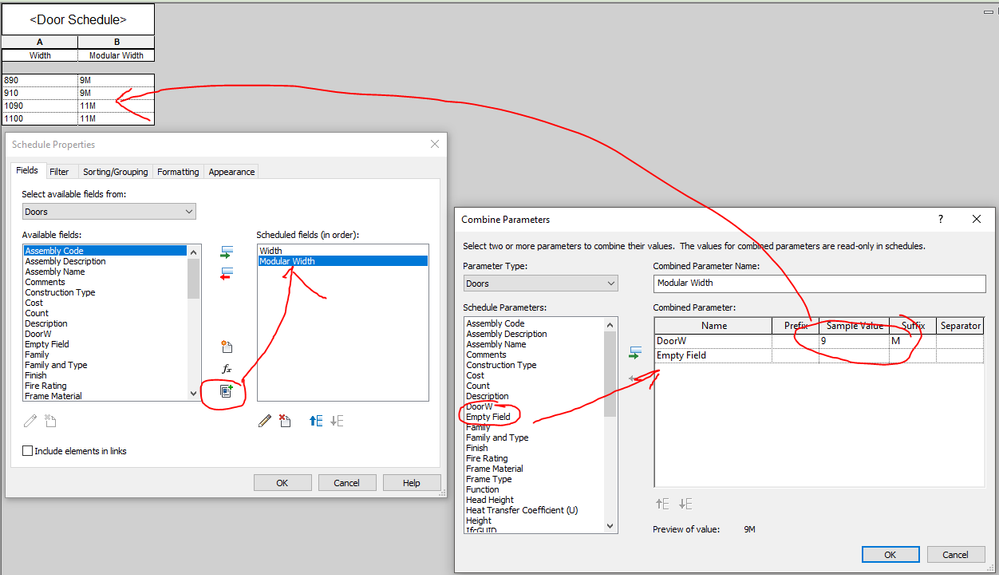

See Revit 2017 attached.

Nice! Oh, looks so simple now! Will try it out, thanks for a nice walkthrough.
Question: Whats the purpose of "Empty field"? :leicht_lächelndes_Gesicht:
Nachricht 13 von 13
als Antwort auf: Marcus.Isacsson
I originally created a field to enter the letter 'M' and combined it with DoorW so the column would read 9M.   Then I realized when combine the fields, Revit allows to add a Suffix, so I added 'M' directly as a Suffix of DoorW.  But the Empty field must be there, though empty, because a combine field must have a minimum of 2 fields.
So, if you have different letters for different door type, make a Type parameter and combine it in the same manner, then you can have things like 9M, 10N, 11L, etc.
