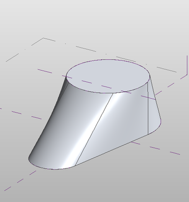

Hello all,
I have an issue regarding the mass blend mode.
I want to produce a solid (created in Rhino) as shown below:
but when I'm using blend (or sweep blend) I'm getting this result:
I've seen that this issue has been raised before but so far I have found no solution to smooth the surfaces.
Any ideas?
Thanks in advance

Revit adaptive can be frustrating to understand. Typically if you are using loft, Revit treat it as loft from 1 line to another. If you have base that has 8 lines and top only have 1 line, then you will get weird lofting behavior.
To keep it smooth like you have in rhino, you have to split the top to the same 8 segments as below.
When you loft, it will smooth the surface.

That is exactly the trial and error I was talking about...splitting wont really help even if user gets to nails combination that works after 2 or 3 trials...once the shape is slightly above average it is impossible to get rid of the edges or smooth them...and when it come to a design modification starts the nightmare.
Lofting is not a Revit thing

Thank you guys a lot for your replies. That was really helpfull.
Even with the blend mode, if you split the top line to the according number of the bottom lines, as @syman2000  suggested, you get it smooth.
But indeed, with the design modification it takes really long time to make them, we already have 8 different shapes of this kind. The frustration keeps with the fact that I have to make them twice, as I need a void shape for cutting through floors..
