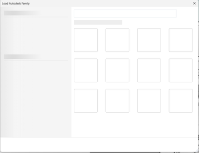

Anyone have this issue before? Any time I try to open the Load Autodesk Families browser it gets stuck trying to open and stays on this blank screen.

Firewall? Disable Firewall and try again.  Does it work now? If so, it's related.  Go from there.
Message 3 of 20
tyler_oneilF6KAD
It was solved by renaming the CefCache folder to _CefCache, thanks

1. Close Revit if it is running
2. Navigate to C:\Users\\AppData\Local\Autodesk\Revit\Autodesk
Revit 2023\CefCache
3. Rename the CefCache folder from CefCache to _CefCache
4. Restart Revit and try Load Autodesk Family again

I’m sharing this in case anyone is experiencing this with Revit 2026: it looks like the CefCache folder is either missing or renamed in this version. To fix the issue, simply delete everything in the Revit directory shown in the screenshot (the directory shown in the accepted solutions on this forum post for earlier Revit versions)and then reboot your computer. Revit will recreate the necessary folders on startup.
In my case, there wasn’t even a CefCache folder—clearing the entire cache directory and restarting did the trick.

Note to follow on this - the new file to delete in order to fix this issue is "WebBrowserControl" located in the same location. You can find this folder by entering the following into your file explorer window:
C:\Users\%USERPROFILE%\AppData\Local\Autodesk\Revit
and selecting your version of Revit. The WebBrowserControl folder can be safely deleted, and will be regenerated the next time you load Revit, fixing the issue.
