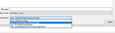

I have a model which is the Architectural model
I now want to create an MEP model.
I set up a new project, using my template from the Architectural Model
However, If I am starting from scratch with this model
How can I get them to share the same project base point? Doesn´t give me an option here

Create a new project from the System template, not Architect template. Link the architectural model in origin to origin and acquire coordinates.
