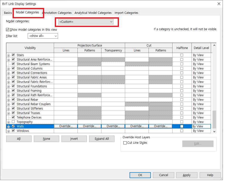

I have a handful of linked revit files in a central model. The model was previously updated from 2013 to Revit 2020. All the links have been reloaded and the revit links in visibility graphics have all been checked.
The issue is that all the links are visible from the exterior, however when I place a camera inside the building, none of the links are visible (missing nearly all my interior walls). Why is this the case?
Attached are some screenshots showing the file from the exterior and interior with realistic mode on.

Have you check the visibility setting of that 3D view?
Message 3 of 9
martijn_pater
When creating the camera you are creating a new view with assigned visibility graphics. In type proporties there may be a preset for view template used applied to new views. Check VG (in template) to see if links are included and/or if a VT is applied for the 3D view.
Message 4 of 9
ennujozlagam
you can create a new view template in the view you able to see all the walls.. etc and then go to your camera view and apply to your view template that template you just created and see if helps. thanks
Message 5 of 9
PavelAnd
Or is it also possible that a model with walls is in a workset that is turned off in visibility/graphics? Or maybe some filters were used to hide the exterior walls? In any case, the answer must be sought in the visibility/graphics overrides of your view.

Well I suppose it could be a glitch, in that case see what happens if you recreate the view...

Thanks ennujozlagam, that seemed to work
