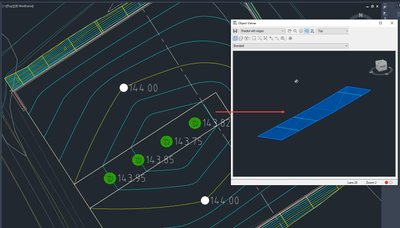

Hi all,
I experience issues when linking topography from Civil 3D to Revit 2024 version.
Allow me to illustrate this post with a really simple rectangular graded surface modelled i Civil 3D. This looks like this:
When I linked this in Revit 2023, I got a Toposurface exactly as the original object modelled in Civil 3D.
But when linking this in Revit 2024, I got a distorted Toposolid I cannot use at all in Revit. This regardless of what Toposolid definition I use (variable og constant thickness, one or more layers...).
Am I the only one experiencing this issue? If not, this renders the wonderful "Link Topography" functionality useless.
Any thoughts/tips here?
