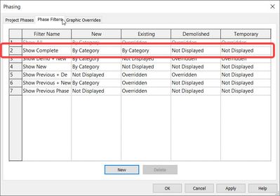

Set your Phase Filter to Show Complete. Here are the settings:

 That work for you, @dharringtonJ5FG4 ?
Nachricht 8 von 8
Apologies, I stepped away for a bit.  Yes it did, thank you.  I completely forgot about phases.  Thanks
