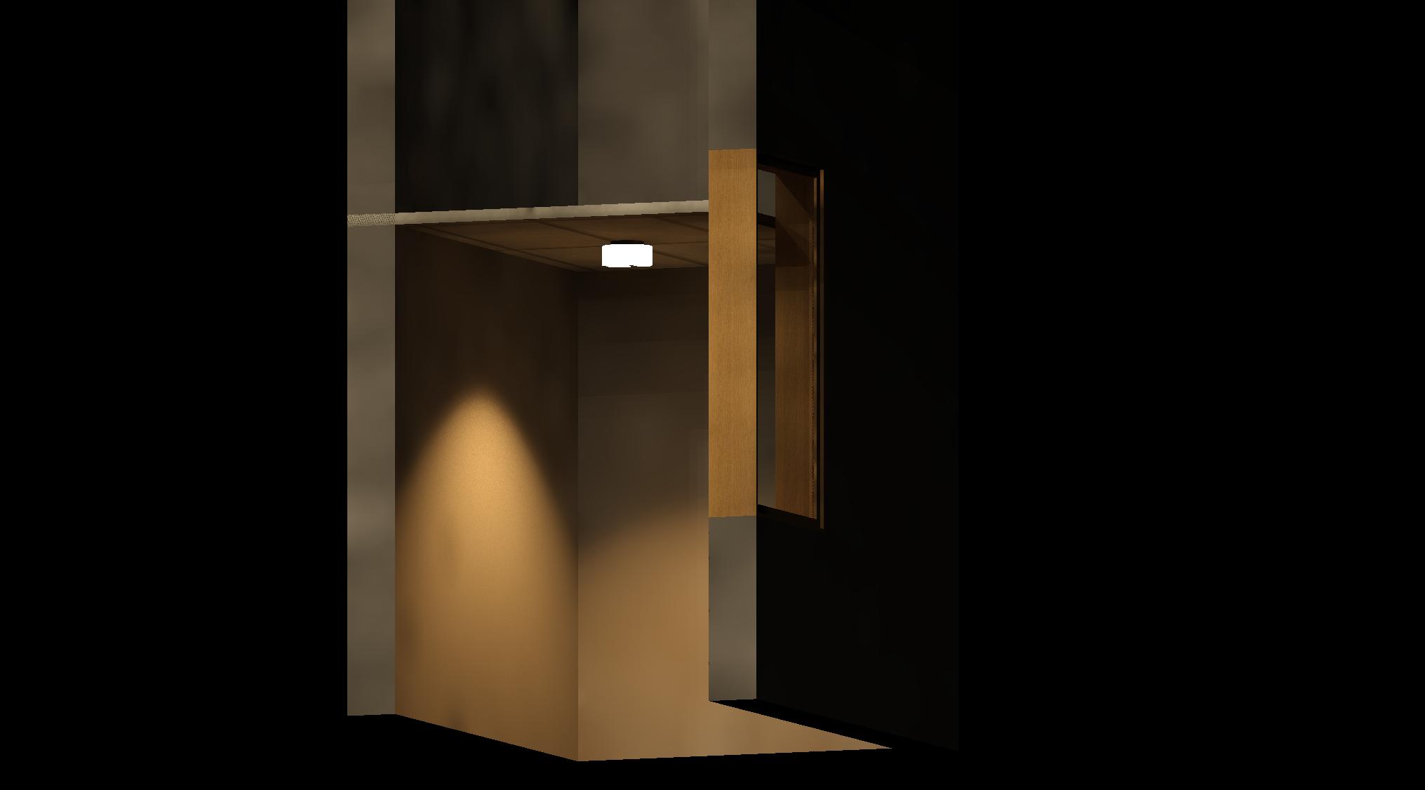

Hello all,
Whenever I render a view the lights I am using render as orbs of light emanating from the bulb. However, the catch is that they only do this when viewed through glazing.
I have attached pictures below for reference. These views are rendered at Medium, Artificial and Exterior Light. The light is 'Pendant Light - Linear - 1 Lamp 48" - 120V' hung at 1' from ceiling.
Thanks!

Here are the results from some additional tests I did. I also used the 'Ceiling Light -Flat round' to check if it was isolated to one light type.

Thanks for your reply. I have tried a couple different types of lights, all with strange results. When I try to pull part of my model out into a new file, the problem goes away. I'd prefer not to attach my whole model here, but are there specific settings I might want to check? I've tried different levels of render quality and interior/vs exterior etc.

... you need to render in better settings
... like high or best
.... here a render in draft mode
... here a render in best (not finished)
.... but you get the idea
... the reflections and refraction on glass are getting way better
