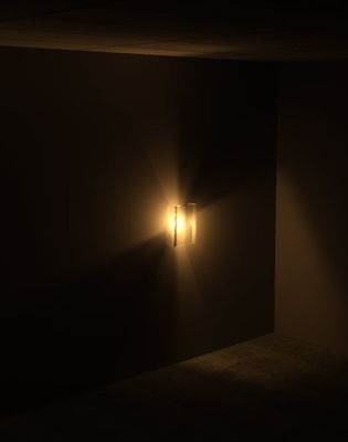

I'm not sure what you are trying to do, but in order to be able to change the light fixture housing Material, you need to associate the geometry's "Material" Parameter to a Parameter in the Family Types Editor.  Then you can change it to whatever Project Material you want to inside the Project.

SOLID MATERIAL WITH SELF-ILLUMINATION APPLIED TO HOUSING GEOMETRY:

You could do this with a Material Appearance Asset that has a Self-Illumination property.  What's the Material in real life?  Look for an Asset in the Browser that has the properties of that Material.
Long and short: it's doable in Revit.  Don't give up.

Here's a quickie for you. Reflectivity, Transparency, Self-Illumination and a pretty Tint added to the plain, old  "Generic" Asset -- the default Asset Revit uses when you create a New Material.   Try it out yourself.
