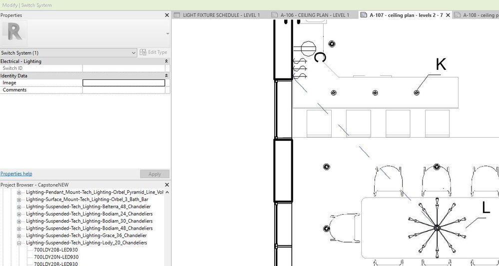

I have a ceiling plan showing light fixtures and switches. I can't select a switch for a light fixture. When I select edit switch system and click select switch, the switches all grey out. The light switches were downloaded as lighting devices and the switch ID is editable. The lights were downloaded as lighting fixtures and switch ID is greyed out. I'm just trying to produce the dashed lines between the switch and fixture, no labeling. I've been googling this issue and nothing is working. I am a student and not the best with revit. I am not able to upload the document because it is a real building and goes against the residence privacy requests. I am able to upload images if needed.

The light fixture family needs to have a Connector. If you got the family from the Architectural library then they usually don't come with connectors. Get then from the MEP library instead or edit the family and add the connector yourself.

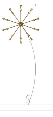

I was able to find a light switch that would connect to the fixtures on revit city, but the dashed lines still aren't showing up. I can see it when it's selected but then they disappear. I can tab and select just the line but I'm not sure what to do to make is stay.

This is starting to sound like a visibility issue (i.e. the connector is there, but not displayed in the view).

I went through the checklist and I'm not seeing any visibility issues. I've attached the switch and light that I'm trying to show are connected if anybody wants to take a crack at it.

This is how it looks on my end. But the line disappears when its not selected. Its not even labeled as a wire. I'm running out of time on this project and I have no clue what I'm doing, so I think I'm just going to draw all the lines in. Thanks for trying everybody :daumen_hoch:

I didn't know I needed to add a circuit. It's working now! Thank you!
