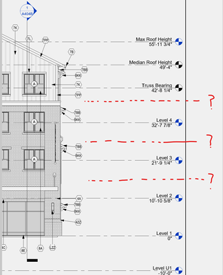

This building uses separate levels than the rest in the project file due because it is on steep terrain.
It is "building D" and I have underlined the levels it uses. You can also see the typical levels the other buildings use:
The levels I need for building D are missing. I believe this happened when I changed the view port from scope box to cropped view. However, changing back to scoped box does bring back the correct levels:
See how the levels are missing below:

Select the levels in the 3D view > Right Click > Maximize 3D Extent

Have you tried removing Crop and Revealing Hidden Elements?

They were there before. For some reason when I changed the view from scope box crop to a cropped region it removed the D levels.
Someone set this project up before me. I am not sure how they included the level D's in these elevations and not the other elevations.
@barthbradley They are not hidden either. I need the view to be cropped on the sheet. Using cropped or scope box and I don't see the level D's....

This is how it should display:

The Levels have different heights. Did you accidently move their Elevation Base?

Type D building has different Heights. That is my point. The other buildings in the file use Level 1, level 2, level 3, etc. Type D building uses level 1d, level 2d, level 3d, etc.

It was turned off via a filter. Thanks.
