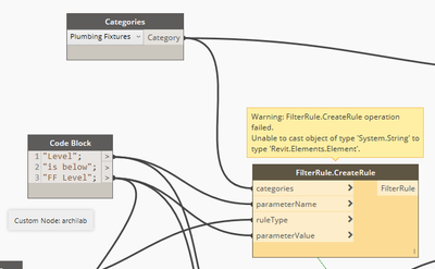

Another interesting thing about this is that I am unable to use the "level" Parameter in dynamo when creating a rule.
There seems to be something unique about the level parameter that stops it transferring, and also doesnt allow rule creation using dynamo.  Frustrating.
Other parameters work fine -e.g. Comments or Mark etc.... but if I input Level it is unable to cast.
