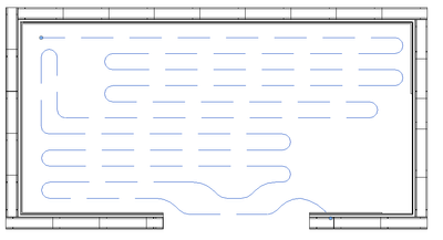

Hello, I need to get a specific length of a string of lines to measure the exact length for a floor heating cable. The ''measure along an element'' tool works perfectly, when the lines are all straight, but no longer works when curves added. Is there any way to get such measurement?
For reference, here is a floor heating string of lines I would like to take measure of:

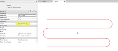

hmunsell
Use a handrail....handrails can include curves and give a total distance.

Corsten.Au
your best bet is the railing for sure..
as @hmunsell mentioned.
