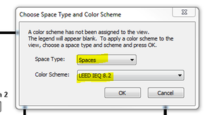

Go to Annotate > Color Fill Legend > Click on your Plan>Select 'Spaces' for Space Type and 'LEED IEQ 8.2' for the color Scheme>OK

5. Go to Analyze >Space>Click on the Regularly Occupied Regions
6. Select The space one by one and fill these two important data on the properties tab or on the schedule
a. Make sure the number is similar to room number that's very important
b.check View-No View thick box if you have a direct line of sight and uncheck it if it has no direct line of sight that's when the color scheme starts to work. You see yellow for view and dark gray for no view
7. Use space separator to draw direct line of sight
When you create an IEQ8.2 plan view (left of the last image) you will automatically have the table for it. You can export this table to excel if you want or you can print a pdf from your sheet view.
You may need to split to discontinue the line where you dont want it to separate (as in Office A on the plan)
