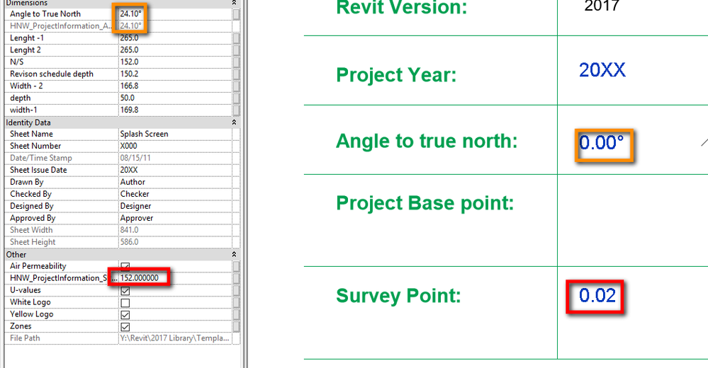

Hi, I have a problem where I have set up a shared parameter which has been added to the project as a instance - Project based parameter.
I have then added the shared parameter to a label within the titleblock. and loaded the titleblock to the project. I have used dynamo so that the parameter is linked to the N/S value of the survey point and this works well within the properties bar. But the value as noted on the titleblock itself does not change as per the value in the properties bar even though it is the same shared parameter.
Does anyone have any ideas of how to solve this?

I've tried changing it to a number parameters and it doesn't link it.  It is as if the parameters box is not linked to the titleblock somehow. As the image shows that I have attached the shared parameters within the red boxes are the same shared parameter but shows as two different values.
the values within the properties bar is linked to the Project North and shows up as I want. But the label within the titleblock I can change separately.
I would like the label to show the value in the properties box.
I would like the coordinates for the survey and project point and the angle to true north to be noted as text on the titleblock and to be automaticly updated when these coordinates change.

Unfortunately I am not allowed to share the project, I would if I could. I am going to try an explain better below and I have added a photo of by title block with the properties bar.
1. I created a shared parameter which is angle based.
2. Added this parameter to the project under project information
3. Opened the titleblock family and made a family parameter called "Angle to True North" so that it links to the parameter within the project base point and allows me to set up dynamo to change this parameter in the family to reflect the actual true north angle of the project.
4. This works with my north arrow which updates in accordance with the Project true North Angle.
5. Added the shared parameter to a label within the title block
6. changed the parameters so that the shared parameter="Angle To True North" (I Have tried changing the shared parameter to a number parameter and adding" /1" but this doesn't work)
7. I loaded the titleblock into the project and as you may see from the extract below the properties bar shows different values than the label. the orange boxes should be the same and the red boxes should be the same. Where the values in the properties bar reflect the value of the project survey point/north angle.

Title-blocks can read the project information directly. No need to push the parameter-value into the titleblock with Dynamo, write the value of angle2North to the project information instead.
In the titleblock family make a label, and add your shared Parameter (angle2North) as the label-parameter.
