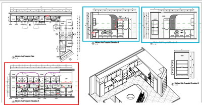

Hi there,
I have a very odd issue that i cant seem to solve. We have 3 elevations of a kitchen area on a drawing, One of these elevations shows the caseworks swing lines (See red box on attached) And the other two don not show these (See blue boxes on attached)
The strange thing is they all share the exact same View Template (Which includes everything) . Nothing is hidden, The same families are used across all views. I cant seem to work out why these lines do not show on the other two?
The only way i can get them to show is if I draw a section and use that. (With the same View Template)
Any ideas?

What happens if you 'Duplicate with detail' the affected views?
Nachricht 3 von 5
ashdon.mcfallVT2XN
als Antwort auf: Simon_Weel
Just duplicates the view as-is. Doesnt seem to add the casework linework
Nachricht 4 von 5
RC_RVT
als Antwort auf: ashdon.mcfallVT2XN
Try making the units slightly transparent, like 20%. Sometimes the projection lines are set behind the front of the door so you can't see them until you make it transparent. If not this, then check the detail level and change it between course, medium & fine & see if this makes a difference. I work with casework everyday in Revit, so if you want me to take a look at your project and see if I can figure it out, then just upload it.

are these details line or what?
share a small piece of family.
