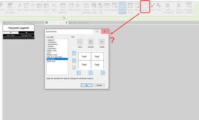

Hello All,
How do we go about changing the visibility of the grid around the cells in a Keyed Note legend? As you can see in the shots below, one sheet has no gridlines while the other does, even though they are from the same Keyed Notes legend. Thoughts?
Thanks!

Yeah, the weird thing is that even though those properties are set the same for the legend, it is displaying differently on different sheets.

On sheet:  VG > Lines > turn off the line styles used for the grid of the schedule.  Go to the schedule appearance to find out which line styles are being used if you don't know.

Actually all lines are set visible in all of the sheets, even the ones that are not showing the grid borders.

Actually, I just had to go to the general legend appearance setting that @barthbradley brought up and check then uncheck each box again. Then it was changed across the board. No idea why.

What I show you is a legitimate way to turn off borders and grid lines for schedules placed on sheets independently from the schedule appearance settings.  If you instead want to do it the way you have then share the file and we will try to understand how it has been done.
