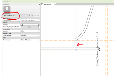

So I can't seem to figure out what is going on here, but I made this K-Style Gutter Profile Family, and I can't get it to project.  I've toyed with thickness of the metal, reducing complexity to simple edges, and making sure that all profile lines connect.  But it would seem that no matter what I do I can't seem to this profile to manifest.
I've even tried using the Gutter Tool, or the Model in Place Tool.  So I'm reaching out here to see if someone here can figure out what I'm doing wrong.

You have overlapping lines.

How'd you find that?  I thought I had exhausted my review of the family.  did you just select each line and try and figure out where it was?  Or do you have an easier way to find these overlapping lines?

Just tab on the profile and you will see a gap where there is overlap.
