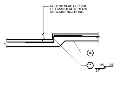

I need to replicate this dimension which is replaced with text:
The method I have used to replicate this is to duplicate the dimension type and change the parameter of the read convention to horizontal, however, I am unable to return the text and to justify the text to the example.

The leader shoulder you can set here. But you have to place manualy
But the text justification i don't know how to do it (Anyone??).
If you don't find any betterway, maybe You can use the ABOVE/BELOW field when editting text
