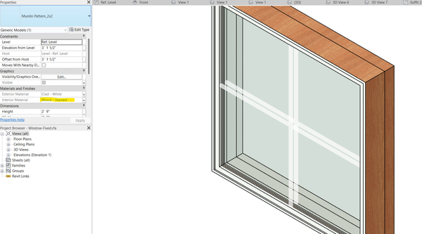

I am trying to figure out why, the mullions on my windows do not show up. I clicked on the window, and it shows the mullions but on the revit file they are invisible, and they are not hidden. The material is there, so that material should show up on the window.
Here in this picture, it shows what is highlighted.

Post simplified Revit project with problematic window. Could be a few things, visibility type or instance properties, view detail level, etc...

Looks like the Material is using Illumination.  Check the Asset to see if Self-Illumination is checked. Uncheck it if it is.

It is not self-illumination, the reason it was showing as transparency was because I selected the mullions. The materials are set as Clad- White and should be shown in that material. I am still stuck.

What's the View's Detail Level. Fine?

Nested Muntin Family Visibility Settings:

Set the view in the project to Fine.

View visibility detail level and I got to see mullions

The one I posted will work at all Detail Levels.
