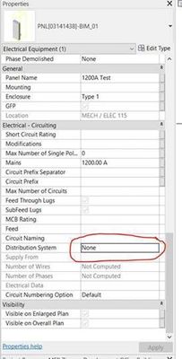

We are able to get the panel in the model however we cannot get the voltage to show up so we can connect other panels.  The light blue rectangle usually lets us select a voltage but we cannot get the voltage to appear for this panel.
This is what we get when trying to connect the voltage, it will not let us set the voltage.

Looks like you don't have one defined in the Project. You ought to just use Transfer Project Standards to transfer Electrical Settings from another RVT -- maybe from the RME sample project.  Food for thought.
