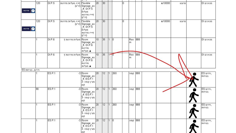

Is there any way to control Image size on schdules?
i want the images to be shown smaller, as icons.

The image size in a schedule depends on the original size of the image and the size of the columns they are placed in.
In a schedule,
  • preferable all images of the same schedule  should have the same size (so that the rows won't look odd)
  • adjust the size of the image (in a photo editing software) to max. 300x300 pixels; they do not need to be larger than that.
  • you can reduce size of the original image down to 150x150 pixels depending on how dense the graphics on that image is

Change the width of the Image column and the images will change their size accordingly.
