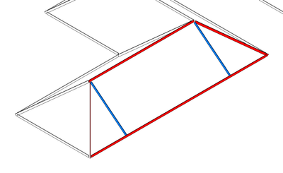

Because everything is interconnected, spans between rafters are dictated by the roof points and are not the same.
Consider this schematic. Rafters must start at points A, B, C, D and F. Those are obligatory. So rafter that starts at point D, rafter 2, also dictates the position of rafters 3 and 4. Span between rafters 3 and 4 is constant, you could use a beam system for that one segment, except, beam system doesn't place beams at the beginning and end of the system.
Then you come to the rafters between rafters 4 and 6. Except, placement of 8 and 9 is dictated by 10 and 11. Which are also connected to the span between points C and B through rafter 1. And so on, and so on...
Either I'm not using it correctly, or beam system doesn't allow any sort of manual control. You can unpin beams from it, but than you're back to manual placing, aligning, extending, trimming... I found it easier to just place one and copy it around, use array where possible. But it's a tedious task.

I think I know what's going to make your day.  3D Snapping.  Do you know where I'm going? Press Beam (Structure Tab) and then on the Options Bar check 3D Snapping. Now use Pick Lines method to place Beams on the Ridges and Valleys of your Basic Roof.  Watch the magic happen.

If your Beam System looks like this:
...when it's supposed to look like this:
...then Edit the Beam System Boundary and add a Boundary Line for Beam Direction like this:

- Left are 3 beam systems so the beams are at exact intersection points (which I think they serve no practical purposes plus you need more expensive connectors, only look neat on framing plan)
- Right is 1 beam system
Exactly, you have to create 3 systems. In my example, where in one field I have 6 different spans between rafters, I found it to be more hassle than it's worth. Especially because beam system doesn't put beams at it's beginning and end.

You can work the beam system to place beams at beginning and end
  1. Either by using Fixed distance and offsetting the System width by 1 x beam Width (b)
  2. Constructing the Frame and using Automatic Beam System for your secondary rafters (That's how it is built anyways .. in Germany at least)
There isn't really a much easier way to model and detail such roofs manually in Revit (regardless of the possible alternatives)
