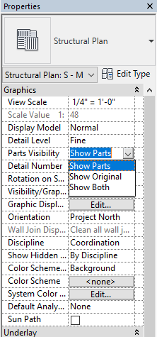

Does Revit allow you to explode a wall so that layers all become detached? example, model gypsum stud wall, explode, then delete or stretch gypsum from one side? I know of the way to do this in edit type, base extensions etc, but was wondering if there is a type of explode tool for this? Divide parts?
Also, does Revit Lt have divide parts?

This is what "Create Parts" is used for. After selecting a wall, use the button on your Modify tab:
Be sure "Show Parts" is selected in your view's Properties in any view in which you want to see a wall as parts rather than an integrated wall (after you have selected a wall and clicked Create Parts).

if you are only stretching one layer edit the wall type and unlock that layer. i don't believe using the parts tool will not allow you to "Stretch" a wall layer, only divide it.

I see, thank you for this. Unfortunately, I'm using Revit LT, I don't beleive this option is avaiable...

Well the easiest way to do that would be-
1. Select the wall.
2. Create Parts.
3. Switch to 3d view and select each part and use displace elements.
4. Repeat the same process for each element.
