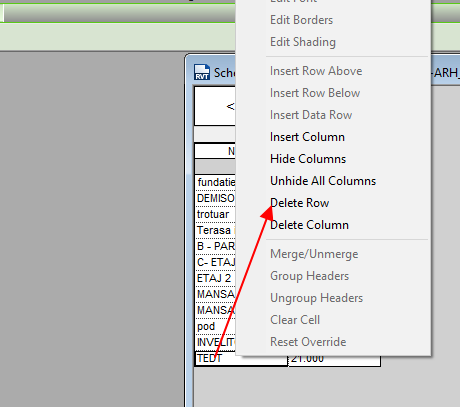

  • you can do a Schedule for Levels where you can control the Elevation, you can change Names or delete Levels:
by right clicking the Row you can delete the Row and with this the Level....
  • another way of controlling Levels, can be by using Dynamo or an Addin...

This schedule solution is quite close to having a 'level manager' actually, nice answer. Worth a try.

This seem like a good idea....how do you create that?
Nachricht 11 von 13
constantin.stroescu
als Antwort auf: svalen
Create a Schedule/Quanties and you will be able to control the Model.
Every change in Model will reflect in Schedule and vice versa...
