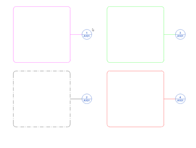

als Antwort auf: BLPenrose
You mean like the magenta, green and red solid Call-outs I'm showing here?
Nachricht 7 von 9
BLPenrose
als Antwort auf: barthbradley
Thank you very much for the solution! I will put that filter together and expect that or something very close to it will solve the issue.
