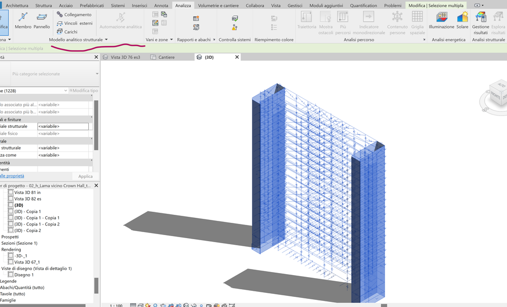

Good morning,
What could I do to fix this problem I caused? Is there a way to bring the analytical model back to the correct position?
A few days ago I moved my project, placing it closer to the levels and closer to the base point of the project. Only today I realized, activating the analytical model, that the analytical panels remained in the old position (orange color), they did not follow the model.
I had never activated the analytical model, not knowing it until I read a comment here on the forum, for this I do not know how to act.
Thank you.

Select analytical elements, right click and choose Analytical Reset.  Or this?

The Analytical Model isn't a separate Model.  You must have missed that element in the move.

f.annoscia1XRNMD
I selected the analytical elements, but the command does not appear, it almost seems that the analytical elements have "dissociated" themselves from the elements of the model.

Or uncheck and recheck Analytical for all structural elements.

f.annoscia1XRNMD
What command should I use to do this?

@f.annoscia1XRNMD wrote:
Do it via properties pallete.
