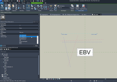

I'm editing a lot of family now.
And I need to lock nest family to my current family, but I pick wrong reference often.
When lock only "reference"(the instance edge of nest family), it cause error when changing the size.
Can I change some setting to not pick the unnamed reference?
Or just tab tab tab tab...
*Edit: Add a simple file to show a nest family with too much solid edges and what's going on when locking wrong reference.

azad.Nanva
als Antwort auf: Sleepingfish_Kuo
did you try to new Subcategory of Reference Plan? so you can hide the your subcategory!!
and for the nest family you can make them Not a Reference:

Sleepingfish_Kuo
als Antwort auf: azad.Nanva
I knew how to use subCategory and "IsReference".
I'm not worry about select wrong reference plane, but the solid edges (or model lines, detail lines, too).
They jump out as a reference when I try to align reference plane as a reference for a nest family's reference.

azad.Nanva
If i understand well,you need to use the TAB to select the right one.I had this problem too for manage the nested family .I solved my problem in another way,could you post a simple family?

Sleepingfish_Kuo
OK, I update it in the first post.
I'm using tab tab to pick the right one, too.
Just want to know if there is a better method.

azad.Nanva
This is good quastion and I can help!
we have two sulotion here:
1- you have the L so you just need to lock one side and use the define the L
2- change the nested family

Sleepingfish_Kuo
Sure it works, but no where to hide these counting parameters.
If I do that for my actually working family... I'll get more than 50 parameters.
(Just a simple, if the nest family's length is not L, but L-r.
Then I need to create another "L-r" parameter for it.)
Or maybe I should give up control some of them, let it be a fix, uneditable family.
And build new family again and again when I need to change something.

azad.Nanva
This is the easiest solution , I can not understand why you should build the family again and again?this is three family nest in one to explain, and yes you should have the L this is normal,or L-something,We should know ,we use the Revit not Magic Wand.
